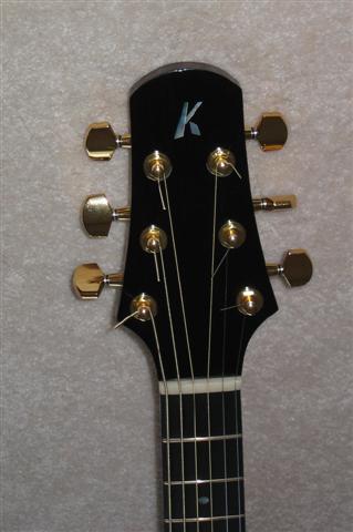

I tried them on my last (4th) build. I didn't notice much of a difference while installing, finishing or playing. Without a side by side comparison with a standard wire, it's kind of a subtle visual difference. To my eye, it looks more vintage than bling. In the pic, they almost look standard compared with the gold tuners. They're actually about the same shade as the strings.
